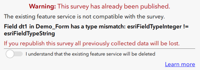

I will also point out that if you are getting the below warning in Connect, then you have a whole other thing going on.

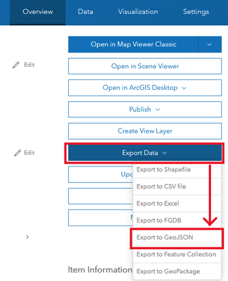

Export:

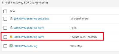

1. Go to your Portal (or AGO) and find the Hosted Feature Layer:
2. Click Export Data > then Export to GeoJSON* Export to Shapefile**:
*Technically, you can use any of the following formats:
** I am revising this to Shapefile. Not sure if it's just my deployment, or an 11.0 thing, but I got a weird error with GeoJSON. Shapefiles work fine though.
3. Download that file once it finishes processing. I like to name my files "delete" since once you download it to your PC, you can delete it. No need for it to sit there without a purpose, after all.

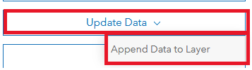

Append:
4. After republishing, go to your new Hosted Feature Layer > click Update Data > then Append Data to Layer:
