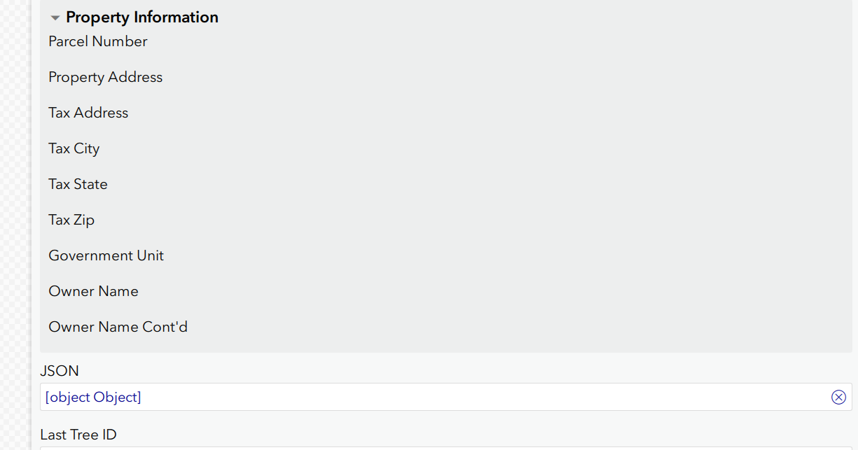

I've been working all day on a custom JavaScript expression in Survey123 and I feel like I'm SO close but I can't figure out what I'm missing.
The inspector we are working with wants to be able to see the TreeID of the last record submitted as they fill out the current survey. I'm using Ismael Chivite's template, 'getLastSubmittedRecord.js' which has been incredibly helpful, but I'm still getting an error result of "[object Object]" instead of a proper JSON response. I looked up this error and found it has something to do with requesting a JSON string instead of a Java Script object, so I'm confused why I am getting it when I'm requesting a JSON string.

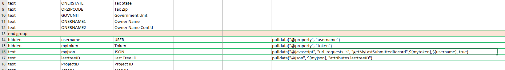

See below for photos and script example

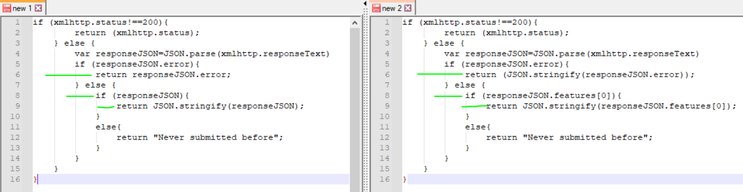

I noticed a difference in your code vs. Ismael's, starting in line 23...
Here's a screenshot comparing the two sections:
Did you intentionally change that section, or does changing that fix your issue?

Hi @Katie_Clark , thanks so much for your response!I think that did fix the issue!

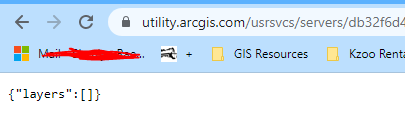

2. When I reference the service created following James' steps in the aforementioned article but continue to use the token generated from the pulldata() function I get a response just saying:
{"layers":[]}

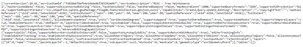

3. Finally I tried manually creating a URL that references the utility service but has no token (to see if the token being used was working properly) and I got this result:
