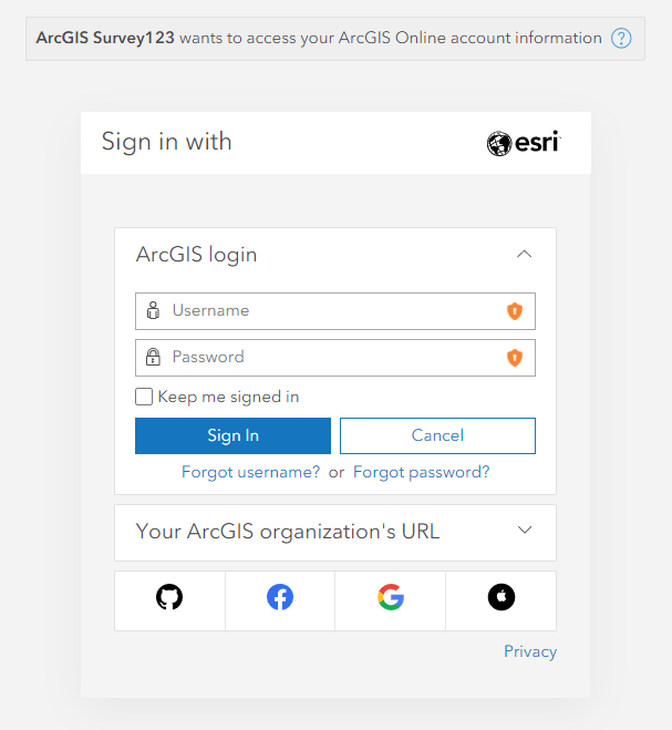

Here's the weird thing: If I've logged in to the Survey123 manager in my Enterprise Portal before I click any of these links, I get there fine. But if I have not (not cached in the browser, I'm guessing), then when I click on the link I am prompted for AGOL login credentials:
But the form is published to Enterprise so...does anyone have any ideas for how to get around having to login manually? I hope that the link would go directly to Enterprise login prompt instead of AGOL.

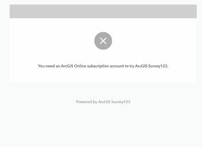

And I get an error saying I need an AGOL organization:
ETA: The warning appears after I'm prompted for sign in via Enterprise, so that's something!

jcarlson
MVP Esteemed Contributor
Oh, whoops! S123 is very sensitive to capitalization in URL params. It's portalUrl with a lower-case P. Try that?
Also, what's the data parameter do? I've never used it.
- Josh Carlson
Kendall County GIS
ZachBodenner
MVP Regular Contributor
That seemed to do the trick! The data parameter seems to select the record in the data table, so that my user (not super tech/GIS savvy) can go from web app to S123 manager and easily export a report based on my pre-loaded template.
