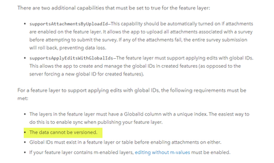

Hi, this is helpful but does not reveal enough as to what is happening. We had a client who wanted to work offline and I am guessing changing the database layers of the feature service to be versioned and may have interfered with Survey123 reading the feature service....
Andrew-Bowne
Ah..   I am not sure that Survey123 supports versioned data.  Check out this doc on working with existing feature services...
https://doc.arcgis.com/en/survey123/desktop/create-surveys/survey123withexistingfeatureservices.htm
