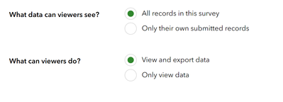

Check the settings at https://survey123.arcgis.com/ then Collaborate tab
PrachiPatel
Submitters have automatic read access. I do not see any other setting for read access/ viewing.
DougBrowning
MVP Esteemed Contributor
And these
PrachiPatel
Thanks Doug! not sure how I missed that tab. I can't seem to save a view access though. It shows the below error

DougBrowning
Oh boy almost looks like it was on then turned off and got orphaned.  Umm not sure at this point.  You may be able to delete it manually and recreate?  If they is production be careful but if testing?  Maybe try a rename on the old one first.  This could explain your errors.
