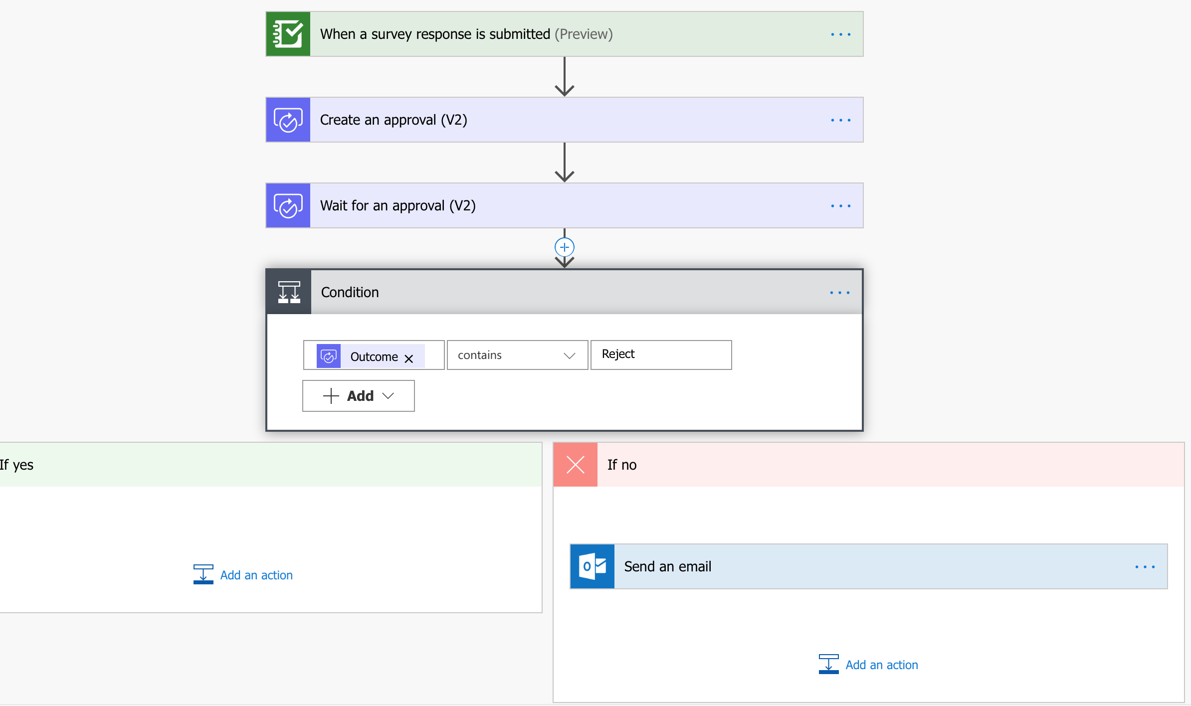

Actually, I've found that this is built into MS Flow - see Create a flow to manage project approvals - PowerApps | Microsoft Docs and Approvals - Connectors | Microsoft Docs .  The first link is a little out of date, but should get you started.  See the image below for a sample I made in exploring this; the 'If no > Send an email' would change to an HTTP action to the feature layer's applyEdits URL that would update the field.

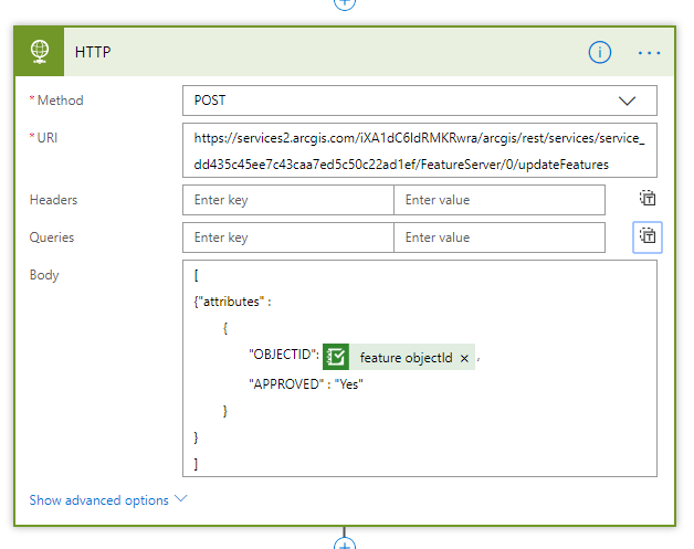

CharlesBailey3
Well I couldn't leave this alone James... have an https request connecting to the feature service through Flow (I think) but it doesn't do anything. The request works fine in the API in AGOL (having to hard code the objectid of course - I tried that in the Flow to no avail). In Flow it breezes right through with status 200 but fails to update the field. What am I missing here? Anything need to go in the header or am I totally off base? Thanks, cob
