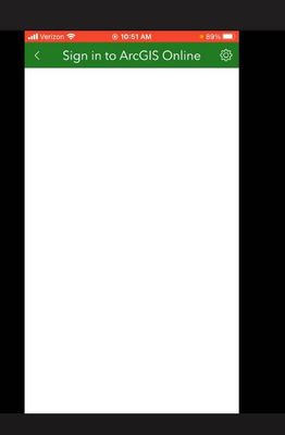

For whatever reason, some users in my company are running into an issue when they try to login to Survey123 on their iPhone 7.
They click the "Login with ArcGIS Online" option and the screen then the next screen that comes up is blank to where they can't even type their credentials to try to log in.

I emailed you a log yesterday, along with a screen shot if that helps. We are using Airwatch for the MDM.
