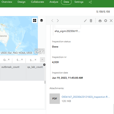

Hi,
Im working on survey 123 reports. I have been trying to enable the pdf report to be attached on the detailed page from the selected record on Arcgis survey 123.
