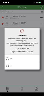

I am having this same issue being reported in my business, screenshot below. Thinking it might be a bug in the lastest survey123 release but im not sure...
ZacharySutherby
Hello @ShelbyZelonisRoberson @najeebhall
For the records that are failing to send, if you open your form underneath the image it may display the name with the file extension of the image. Something like "<image_question_name>_<timestamp>.EXIF".
If the image extension is .EXIF this is a known issue with the 3.20 release and is logged as BUG-000168671. This issue should only happen on iOS devices. For the time being to work around the issue in the iOS settings for the camera capture formats change the setting from "High efficiency" to "Most Compatible"
