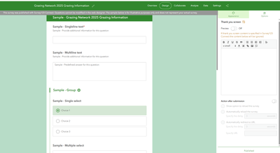

Hi Abigail Stephens‌. Yes. This has been resolved:
  1. Publish your survey with Connect
  2. Login to survey123.arcgis.com
  3. Open your survey in the designer
  4. Click on Settings
  5. Configure and activate the Thank You dialog.
  6. Publish from survey123.arcgis.com

NielsPerfectPlace
This does not seem to work for our Survey. I change the settings, publish the Survey again and refresh the page. The setting is then turned off again. Is it available in 123 connect already, or should I recreate all my surveys in the online version.

Hey @IsmaelChivite and @JamesTedrick ,
Have you added the functionality to Submit another Survey to Survey123 Connect.  I'd prefer to not have to take a survey that was created in Connect and edit it in the Web Designer.
And apparently even if I wanted to edit it in the Web Designer, it does not let me since it was published form Connect.
It would be extremely help to have this functionality added to Survey123 Connect.  I'm having a hard time understanding why it hasn't already been added.
