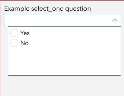

Survey #1 has a list (select_one in this case):

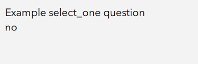

Survey #2 is linked to the same Feature Service as Survey #1, and also has the inbox enabled allowing the user to see all submissions from Survey #1.
Within Survey #2, I turned the select_one into a text field, and then made it ready only. When viewing the submissions from Survey #1, this is the result:
Form #1
Form #2
