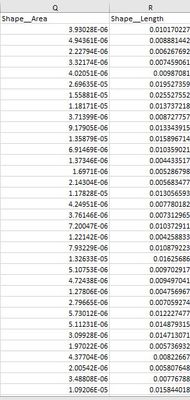

What units are used in Shape_Area when Exporting Polygons from Survey123 to csv or Excel?? I used Hectares on the Polygons in the Survey and appeared on the excel in exponential figures..  

area and length are always calculated in the coordinate system of the featureclass.  These data suggest a GCS in decimal degrees.  Nothing changes these values although they can be calculated or shown in a different coordinate system, in a variety of places, which has what has happened here.  If you need values in metric units, you will need to take the extra steps to get them in your table.
