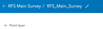

Survey123 will look for the layer using the table's alias. Can you confirm that the layer's alias has not been adjusted, and still includes the underscores?
If I took my own layer pictured below and edited the alias to omit the underscores, my form would no longer work.

ClaireField
Doesn't have underscores anymore. I don't believe I changed anything. I see what you are saying.
This is on my settings page, should it look for this or the underscore version?

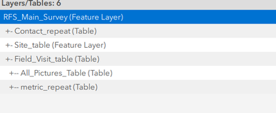

ClaireField
I wanted add another screenshot: The actual layer has underscores

Interesting. I've had issues referencing layers with spaces in the name, but maybe that's been fixed. Whether you go with spaces or underscores, just make sure that the actual layer name and the settings tab of the survey say the same exact thing.

ClaireField
I wanted to add more information - the schema:
And the ARCGIS Online Layers -
