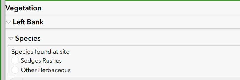

I cannot figure out what is going on here.  I torn down the list to just 2 items and they work fine.

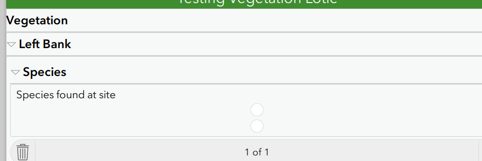

If I add in a simple choice filter it just show the radio with no text.  It even adjusts to the correct number of choices but never a label.
I do not think it is a label problem since they do show without a choice filter.
hidden AlwaysLookup AlwaysLookup "Y"
select_one SpeciesList SpeciesFound Species found at site always=${AlwaysLookup}
list_name name label image label::language1 woodyherb statecode nonnative always
SpeciesList SedgesRushes Sedges Rushes None Y
SpeciesList OtherHerbaceous Other Herbaceous None Y
