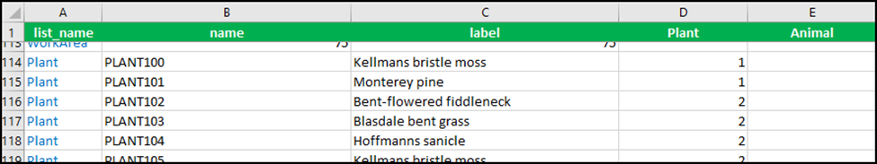

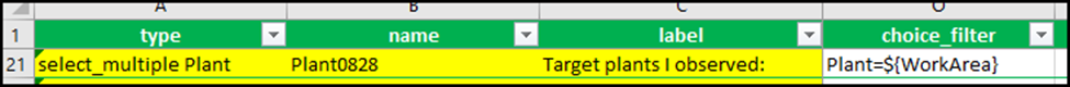

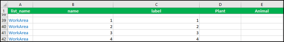

This works perfectly when an answer is selected!
We have a target list of plants to look for, and I need to include the rest of the list in another field. Is there a formula that would give my all the plants that didn’t get selected?
Thank you for your help.
