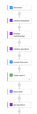

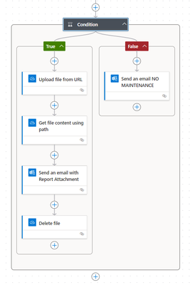

RobertAnderson3_0-1726596548284.pngRobertAnderson3_1-1726596561221.pngRobertAnderson3_2-1726596589310.png
Hi @SeanNagy1 This is the way the flow looks that I have that creates a summary report every week. I have a Condition in there to check for no results because sometimes I won't have any based on my WHERE clause.
Hopefully that can get you started, but let me know if you have any questions.
