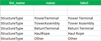

@MarkWilkinson1, it seems like you want to use geopoint for signs and booms, then geotrace for fences, gates, barricades, is that correct?  Do you have any features you need to collect with geoshape (polygon) representation?
I might suggest implementing a "featureType" or "structureType" select_one to provide an option for different features in a single Survey123 XLSForm.  Then you could use relevant functionality to show/hide the questions and fields that pertain to the item selected during one survey instance.

@MarkWilkinson1, take a look at this generic form (attached) showing use of  multiple geometries, two geopoints and one geoshape, in a single survey.  I learned how to do it from this thread.  In my demo example, the geopoint named "Device_Location" is a "primary feature" of sorts, meaning the subsequent geometries (which have to be listed under repeats)—a geoshape named "Feature_Boundary_Polygon" and a geopoint named "Feature_Center"—will be related to the  "Device_Location" point.  One could configure the parent/child geometries differently, depending on what's needed for the survey design.  For example, one could use a geoshape (for a polygon) as the primary geometry and then have a geopoint, a geotrace, and another geoshape be in the form (all related to the first geoshape).  Note that there will always need to be at least one geometry outside a repeat if multiple geometries will be used in one form.  Note that I put a "1" under the repeat_count (Column P) for the secondary features, because I want only one boundary polygon and boundary center point per survey device point.
