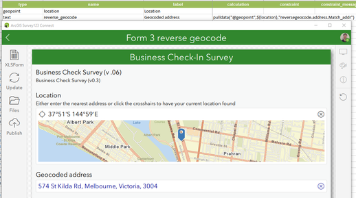

I added a text question to your xlsx file and used the above pulldata() example, and it works as expected. See below screenshot. When I select a point on the map, the text question is updated with the geocoded address. I am using the default locator service (ArcGIS World Geocoding Service).
