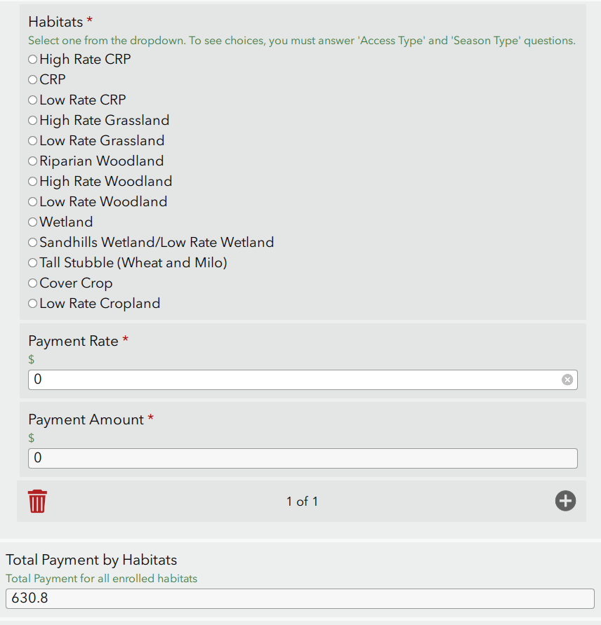

Hi, I encountered an issue with Survey 123 about a month ago now. We need to do more data collection, so I'm searching for a solution.
The workflow is the following: I have a choice list that is dependent on an answer earlier in the survey. This choice list is in a repeat. In my example this choice list is habitat types. I also have questions in my repeat that deal with number of acres, and rate per acre. Calculations are done in the repeat and outside of the repeat. When finished with the survey they submit the survey and refresh their inbox. If they need to go back and update the survey with changes, all the calculations are still populated, but the answers for habitat types in my repeated choice list have disappeared. It acts like there has been not been a submission before. So I fill it out again and resubmit. However when I open the Hosted Feature Layer it duplicates my repeats. If I had three before, it will have six entries. I'm guessing this is because I reentered my repeats to submit my survey since these are required fields. Below is what it looks like when you reopen the survey to update. No habitat circle clicked, no multiple entries, but my Total payments by habitats is still populated.

Hi there- I'm noticing this issue too in my own survey, and I too have "allowAdds= True allowUpdates=true query" in the bind parameters column. When my field guys open up a submitted survey from the Sent folder, the data that they entered in the repeat block of the survey isn't there. The data is still in the feature service at least, but on their device they can't go back and see what they submitted in the repeat block of the survey. Did you figure out a solution or a workaround for this? Thanks!
BrandonArmstrong
Hi Matt,
Can you please take a look at the following Forum Thread and see if this is consistent with the behavior that you are encountering?
If it is related to data not appearing in the first repeat, but showing in sequential repeats, the fix will be applied very shortly and can even be accessed now via our Early Adopter Community: Welcome to our Feedback Community
