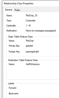

Thank you @DougBrowning . You have given me a few routes to try, and I will report back on success. I am not concerned about labels at the moment, so the bug shouldn't be an issue. I have attached a few screenshots for your consideration.
Yes, you are correct that I have an existing points layer for the Plots (origin) and then a standalone table of Trees (destination). I used the Generate GlobalID tool to create the GlobalID field for the Plots and then added a GUID type field for the trees which I named parentglobalID. I filled the parentglobalID field in Trees with corresponding values from the Plots' GlobalID field, and then used these two fields when I created the relate.
Do you mind clarifying what you meant by 123 needs the repeat key to be parentglobalid? I have attached a screenshot of the repeat wording in the XLSForm, referencing the child/related table. Is that not correct?

You need a GUID field in the repeat called parentglobalid (note it is case sensitive but you posted ID in caps so fix that)  since that is what 123 needs to populate for the key.  You cannot just make any GUID field it has to be that name.
Also you have a reserved work in your screen shot which will cause issue.  The little green box it telling you its reserved and cannot be used.  Make sure to fix that.
Again the best way to see how it works it to copy the form, publish it, download the GDB, then match your service to that.  You have to do it the way 123 wants.  I do it the easy way and just use the 123 GDB as my base.
