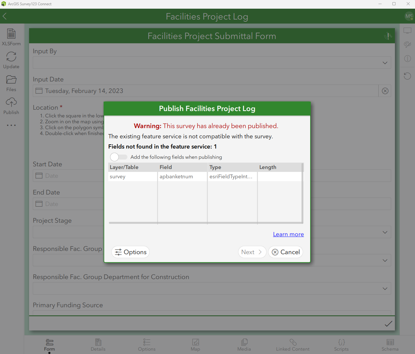

I originally created and published a survey in Survey123 web designer and decided to make edits to the survey in Survey123 Connect (to explore the advanced functionality). Within the xls file, I deleted one question and added a new one. When attempting to publish the updated survey to my organization's Portal, I run into this message:

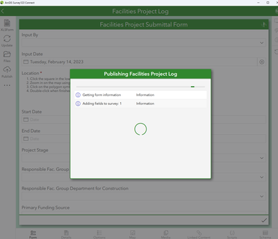

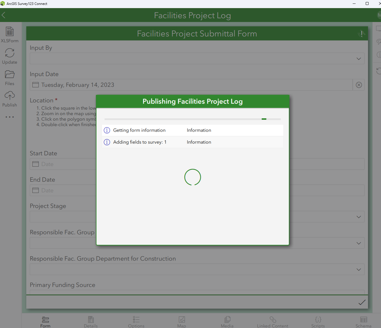

I toggle on "Add the following fields when publishing", click next, and then encounter this loading screen:
This window stays open indefinitely and does not publish the changes to the survey up to the portal.
