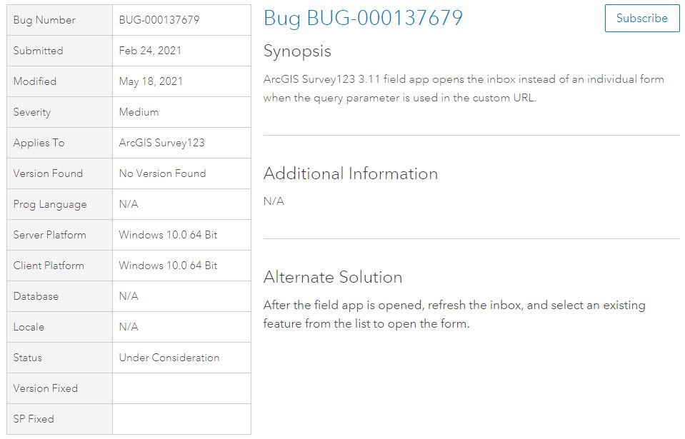

This issue is still in our backlog list. You may track the status from this salesforce issue. Our internal issue covers all the cases using custom URL parameters, and when the fix is availalbe, it will be included in this salesforce.
BUG-000137679 ArcGIS Survey123 3.11 field app opens the inbox instead of an individual form when the query parameter is used in the custom URL.

Status of BUG-000137679 'Under Consideration'

BUG-000137679 is marked fixed as of version 3.14, but I still encounter the issues described in the original post when using 3.14 on both Android and Windows. If the bug is fixed, a response to this request from the original post would be appreciated:
Does anyone have a working example of using the q:queryparameter URL parameter to launch Survey123 (Windows or iOS/Android) [edit]from a pop-up and open an existing survey for editing?
