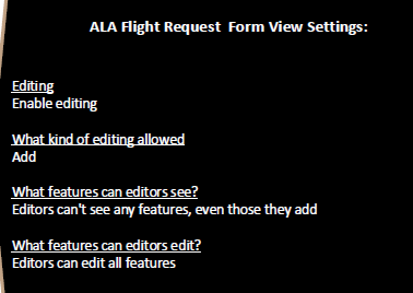

The FL view we are submitting to has the following settings:
Could this be the problem?
