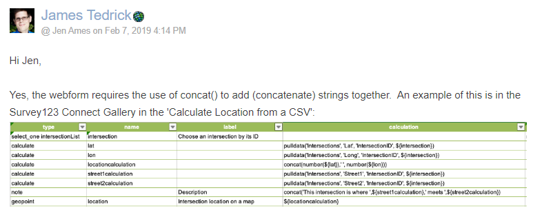

Many factors can cause it not working, such as browser (e.g. IE 11 didn't work well before), something wrong with the csv file: Survey 123 Webform error with .csv pulldata, or something wrong with the calculation statement (see James's comment on this page: Calculations on Geopoints).
It seems like web form is just more sensitive with little things compared to mobile app, or they are simply written by different language so that they behave differently with the same calculation statement.
