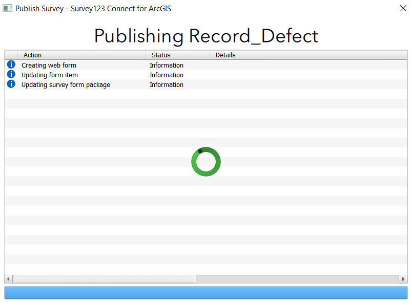

Hi all. I have a survey built using a feature layer. I published this a while ago and everything is working. I have a choice list populated with some staff names. I added a name to this list and tried to publish it again. Everything goes well, until it hangs at the "Updating survey from package" bit. Have anyone experienced similar?
I'm using Survey123 Connect v 2.8.4

Hi Schalk,
In the log is a line:
<10>1 2018-07-06T08:17:04Z dub-lt-03129 Survey123ConnectforArcGIS 19604 - [AppStudio@11205 category="qml" function="onFailed" filename="PortalRequest.qml" line="79"] qml: PortalRequest failed: url https://www.arcgis.com/sharing/rest/content/users/XXXXXXXX/da6658a7bf5b46d0beabf5fd4aa71d91/items/29... error {
"code": 400,
"details": [],
"message": "Item does not exist in this folder.",
"messageCode": "CONT_0005"
Has the survey been moved from the original folder? If so, you'll need to update the .iteminfo file with the new folder id.

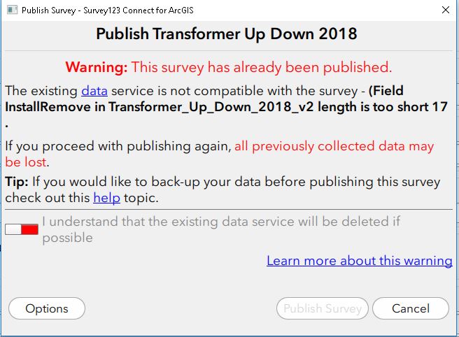

JasonTrussell
I am having a similar issue, just updated to the latest Survey Connect  2.8.4 and that did not help.  I updated my Employees names in the choices and I am getting this error.  I did not change anything within the survey.  It has never done this, i update the choices often. Let me know if you figure anything out.
Thanks
jason
JamesTedrick
Esri Esteemed Contributor
Hi Jason,
Your error is a bit different than Schalk's.  This is being caused by one of the choices you added having a choice whose name is longer than the maximum length allowed (when this was published by an earlier version of Survey123 Connect, the field was set based on your choices at the time).  Take a look at your choices for that question and make any choices longer than 17 characters shorter.

Hi Schalk,
It looks like there might be an issue with the form item upload.  Can you attempt again while logging? (click the gear icon on the main screen, select 'Diagnostics' and turn on logging).

Thanks very much for the reply. I attach the log file.
I don’t see anything popping out at me in the log. Can you?

Hi Schalk,
"code": 400,
"details": [],
Schalkvan_Lill1
Completely missed that. Yes, the survey form was moved. Thanks James.
