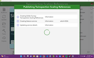

Hello all,
I am trying to publish a simple survey meant to collect some basic data for a field site (site ID, customer name, geolocation), along with some captioned images. I have written many surveys for my company, and this is hands-down the one with the smallest footprint. However, when I go to actually publish the survey from Survey123 Connect, I'll just get an eternally spinning green ring while Survey123 Connect is "updating service details". I have been trying to publish this survey for the past week now to no avail, and I haven't gotten any responses from Esri Tech Support about this.
I have successfully published a number of complex surveys with Survey123 Connect, so I am completely at a loss as to why this one doesn't work. It is alarming to me, as I can't find any information about it in the forums and I will certainly have to create new versions of existing surveys in the coming months.
The only information I can get about this issue is that if I close Survey123 Connect in the middle of the publishing attempt (sometimes after literally hours of "updating service details" being the status), and then try to republish, the second attempt will fail because a folder + feature service of the survey name are both created in my AGOL Content page; however no Form or Web Map items appear. I have to delete the useless folder in order to try publishing again, but the result is the same.
This particular run was started at 9:45am local time. Survey123 Connect does not indicate any issues with the survey form when I try to publish.
