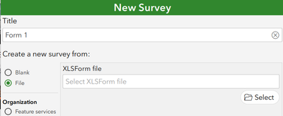

I'm not sure I fully understand your question, but if you wanted to have a survey to use as a template for the future, you can save the XLSForm in your files somewhere and create a new survey using that file (Create a new survey from file > select the template XLSForm). All questions will remain the same and can be altered as needed.

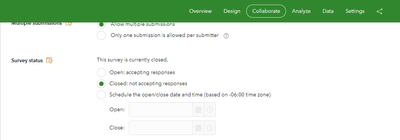

If you wanted to host the template but not have it be enabled for submissions, you could publish it the same as you would a live survey, and then on the S123 website, change the Survey Status under the Collaborate tab to "Closed".
