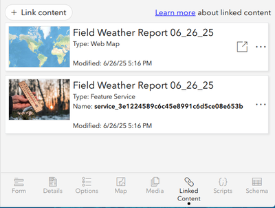

Hello @NataliyaLys
Check the Linked Content tab in Connect to see if you have any web maps that are linked to the survey, additionally if the source hosted feature layer is linked to the survey.
Try unlinking the source hosted feature layer, or if there is a web map linked to the survey check the web map and switch the feature layer in the map from the source hosted feature layer to the feature layer view.

Hello @NataliyaLys

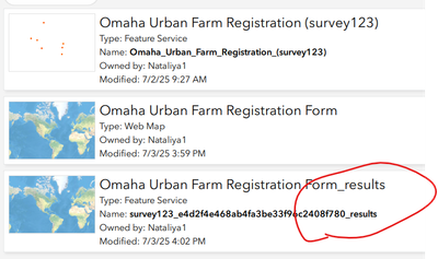

NataliyaLys
@ZacharySutherby
I think the issue is with the linked content. I noticed that in addition to my submission url service (the one with survey123 name in parenthesis) , there is also a 'results' feature service linked. And I cannot unlink it from survey123 connect.
I created a new survey from my existing form, I then I published the new survey, pointing it to the same submission URL. Then I went to survey123 online Collaboration > Share results and when I shared results it create a new 'results' view and that results view got linked 'linked'. I deleted '_results' and it disappeared from the 'linked content'.
