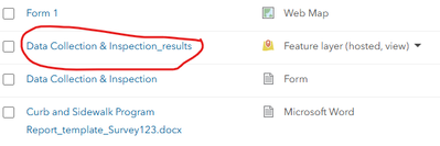

dsinha
Hi @ZhifangWang, yes the two data sources have the same property ID which can be used to connect them.
I am not sure if the pulldata function would work in this case as the data collection is being done through Field Maps. I am using Survey123 to only generate the report (using the spatial layer from the Field Maps).
It is possible to modify the ****_results layer in Survey123 without modifying the source spatial data layer? Then I can add the pulldata function in the ****_results layer without modifying the source layer.
Thanks for your help!
dsinha
I think it would be simpler if I just autoppopulate these fields in Field Maps itself using the FeatureSetByName function. I will try that.
ZhifangWang
Hi @dsinha ,
Thanks for sharing the information. The pulldata layer expression I mentioned previously is used to query a field value from another layer in Survey123 when filling the form, which should match your workflow. I think you should be able to achieve the same using Arcade in Field Maps. Submitting the value into the spatial layer could be a workaround to help you generate the report.
