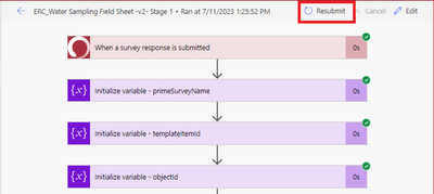

  5. This got me thinking... I went to another flow that wasn't working, found a previously successful flow run, and hit "Resubmit". The flow ran as it should, and this magically "jump started" the trigger to act the way it should, thus fixing my flow.

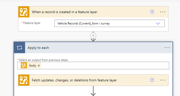

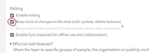

We originally created our trigger to point to the base layer (1).  But the trigger was not firing when we added new records using the Survey123 form.  After working with an Esri support analyst, he determined that it was the _form view (2) that was actually getting called when a new records was added to the survey.  So we switched the trigger to point to that "_form" view (2) instead of the base layer (1).  We had to make one more tweak to get this to work.  Although the base layer had the "Keep track of changes to the data" setting checked, the _form view did not.  So we check that setting on the view as well:
Once we did that, the trigger began to fire when a new record was added.
Here is what the start of the workflow looks like:
