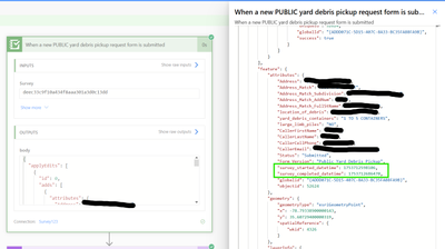

CalvinHarmin
MVP
If you use Survey123 connect, you can specify in the XLSform that the survey should include the built-in survey "start" and "end" types, i.e. when the user opened the form as start, and when they hit the 'submit' button as the end. These are in UTC epoch millisecond time like the other AGOL date fields. You can 'name' these fields to be whatever attribute name you want them to be in the hosted feature layer; these are different from CreationDate although often the survey end datetime should be basically the same as the CreationDate time. They are hidden by default and do not show up to the form users. However, these dates will be included in the output of the Survey123 webhook attributes if you use them.
