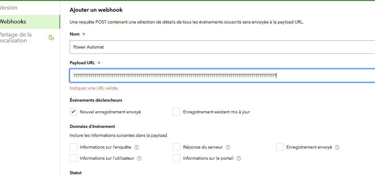

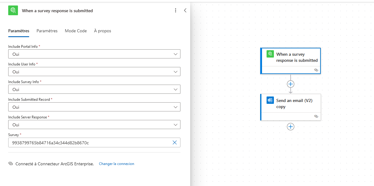

I've followed the whole procedure, all the Test are working but I'm stuck on the configuration once in power automat, I've created a very simple flow from the connector and a mail sending but I can't find anywhere the URL payload to trigger the flow?
Am I blind or have I missed something?

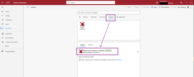

After that, you can start a new flow and select your Custom When a survey response is submitted trigger:

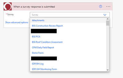

Once that is added, select the drop-down, and you  will (should) see a list of all your surveys:
Make the selection, add any additional steps you want, and then save your flow.
After saving and turning this flow on, you will notice the associated survey will have a pending update. That update is Power Automate adding a webhook to the survey for you (and without that update, your submissions wont trigger the flow).

Remi_Foicik
Hi @abureaux
Ty for your answer, it works perfectly !
the problem was that I was trying to configure my feed on another user's survey with the form's itemID.
