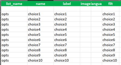

Oh! I see, you'd like the list of choices filtered, not just pre-selected. I think the only way to do this is to utilize the choice_filter column. See: https://community.esri.com/t5/arcgis-survey123-blog/survey123-tricks-of-the-trade-choice-filters/ba-...
I haven't combined a JS function and a choice filter before, but this is still doable using a hidden question and a choice filter.
  1. Have you JS function return a comma-delimited string of choices
    1. "choice1,choice4,choice5"
    2. This is the format of a select_multiple
  2. In your choices tab, create a column. I have named mine filt.
  3. Have the values in this column directly correspond to the choices themselves.
  4. Create a hidden question that pulls in the string from your function. I've called mine strlist. For testing, mine is just a text field, but it works the same when hidden.
  5. In your select_one question, set the choice_filter to selected(${strlist}, filt)
  6. Try it out!
Here's my test. You can see that my options are limited to those items in my string list.
EDIT: I should say, set that hidden question to a null type so it's not part of the output schema.
