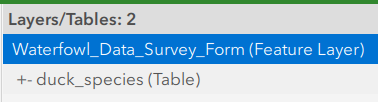

In your case it is creating a table only for the repeat, which means "duck_species" is not a layer, and does not have any geometry fields in feature service for that table.
I beleive this is the reason for the operation rollback error. Looking in the logs can see the following:

This would indicate that geometry data is trying to be submitted to a table in the feature service which it can not process as there are no geometry fields on that table. You need to re-publish the survey, create from scratch again, ensuring the repeat is created as a layer. Do this by swapping the order of the null geopoint under the other geopoint, and then after successful publish you can put the order back to how it was.
As for why it worked in Enterprise and not AGO, it is likely since creating the survey you added the extra null geopoint and/or changed the order. Probably the first time you publishing that survey in Enterprise there was only one geopoint and it was not null. Just a guess, as the publishing process is the same, so you woudl get this problem now if you also publish the xlsx file as it is to Enterprise again.

It was that gepoint questions.  I removed the first null one, published, added it back in republished and all is right with the world again!
When I first created the form on portal I didnt have the null geopoint question, that was added some time after.  So thats why a straight copy and publish to AGOL caused the problem.
