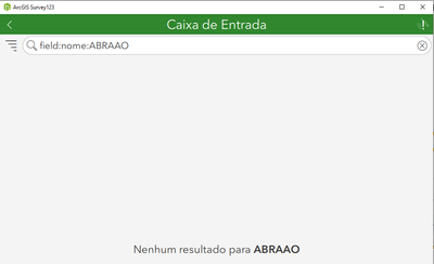

SMDSAdministrador
Hi James. Regarding the filter, I can't get the filter to work on a specific field, even with the pattern in your example
I've tried arcgis-survey123://?itemID=6aae34254266436a96f35c5709cef409&filter=field:name:ABRAAO&folder=inbox and other variations, but I still can't filter the "name" field with the specified text
When using arcgis-survey123://?itemID=6aae34254266436a96f35c5709cef409&filter=ABRAAO&folder=inbox, it works. The problem with this is that if there are other occurrences of "ABRAAO" in other fields, the filter will also be applied.
Is there any way to filter a specific field (other than by "q:<queryparameter>")?

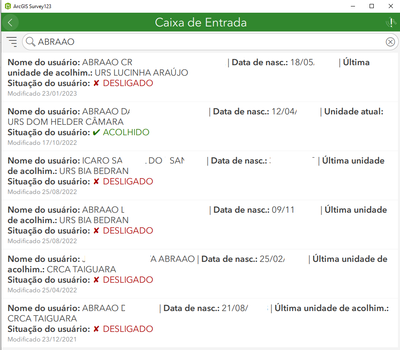

SMDSAdministrador
Hello, @ahargreaves_FW
Yes, this method I know and I know it works well even on Windows. His problem is that he filters the desired string in the entire database.
For example, in the second image of my previous post, the 3rd line of the inbox has the name = "ICARO", however, there is the string "ABRAAO" in another column of the database (and, therefore, the filter returned that line, which is behavior I wouldn't like)
I'd like to filter a string on a specific column (in this case the "name" column) as the documentation says it's possible (but unfortunately I haven't been able to get it to work yet)
