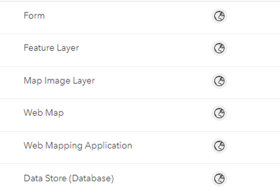

That should work if you've shared the feature service and the survey to everyone.  Something to check is whether the portal items for both the feature layer and the map image layer created from publishing the service are shared to everyone - with feature access being a capability of a map service, it is necessary to share both portal items.
Hope this helps!
Craig
Edit: While I've seen issues with this in the past, I have verified that having different permissions on the map image layer and the feature layer shouldn't be an issue in this instance.
KristinVernon1

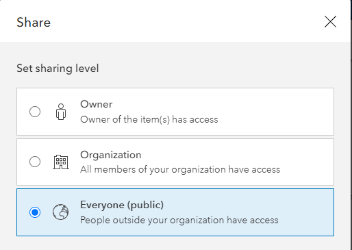

Hey thanks for responding, I've set everything to public in the portal, do you mean when publishing from ArcPro there is something I have to set to public from there? Here is how i have it shared in the portal:
Thanks for your help!
KristinVernon1
So I probably didn't make it clear that the feature layer I'm using is not hosted. But still I share it as public and when submitting a survey anonymously I get this error:
CraigRussell
Thanks for the updates Kristin.  The sharing all looks good there.

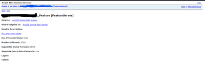

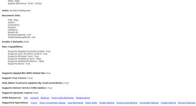

What happens if you open the rest endpoint for the feature service in a private/incognito tab without signing in?  Can you access it and see the editing operations like Apply Edits, Add Features etc.?
KristinVernon1
Is this what you mean (openend in an incognito window):
CraigRussell

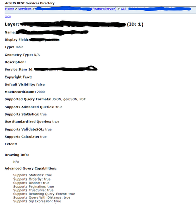

There's nothing showing under layers or tables - can you navigate to any of the layer IDs?  i.e. add /0 or /1 etc. to the FeatureServer URL?
KristinVernon1
My apologies I do have something under "Tables" but I mistakenly cropped it out, I can also open it in incognito:
CraigRussell
Well that all looks pretty good...
