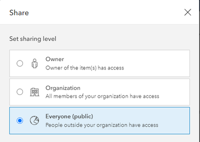

I have an enterprise geodatabase table that I published to my organizations portal as a feature service. From that feature service I created a survey in Survey123 Connect. Due to our license we only have a limited number of user types that are creators and a surplus of viewers. So the users who would be using my survey would be viewers. Because of that I thought i could share the feature service and the survey as public and then anyone on our network would be able to submit to it (even without an account). However users without an account cannot submit and also users with a viewer account.
When submitting on no account I get a 500 error and when submitting on a viewer account i get an error message stating i do not have edit privileges.
Is there anyway to make my survey public and submissions open to anyone from the feature service? Or maybe there is another way I can go about this?

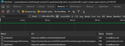

Developer tools in your browser are usually launched by either pressing F12 or Ctrl+Shift+i - this is what it looks like in Edge:
So what you need to before opening the developer tools is open the survey and complete it right up to the point before submission, then open the developer tools, then click submit.  The Network and Console tabs on the dev tools will capture the activity that happened at the time of submission and may give some insight as to what went wrong.
You can save these logs by right clicking on any of the entries and choosing Save as...
Given that it looks like you've got the setup right, I'd also suggest raising this with your local Esri tech support - they'll be better placed to diagnose, confirm if this is a bug or known issue etc.

So the test proved successful. I shared a feature service and made it public with only one textfield in the same way that I shared my other feature service and I could submit to it anonymously when shared publicly. I noted however that when I share the survey public I have to share permission to submit and view results publicly as well. When I change permissions to view the results by only a certain group it changes in the share survey submission section as well (basically both the results and submission has to be public. So everyone in my organization will be able to see the survey submissions?). This is a bit counterproductive.
