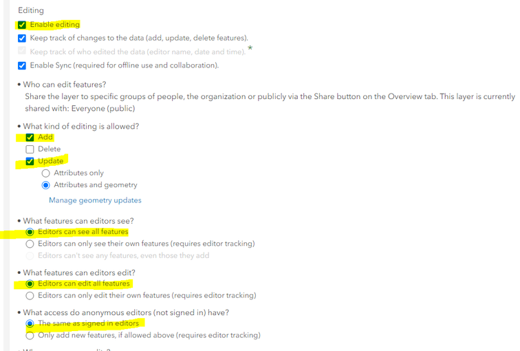

Hello.  We have had great success embedding Survey123 forms (built using Connect) in our Dashboards.  This allows us to add new survey records and edit submitted ones directly in the embedded survey, and see the results in the dashboard web map and associated elements.  Following this model, we built a dashboard to review and validate lead service line survey submissions as part of our service line inventory.  We began noticing the error in the screenshot below.  This error occurs when we attempt to edit an existing survey record in the dashboard as the first thing we do.  If we then open the Survey123 web app, refresh the dashboard browser window, we can then submit the record successfully in the dashboard environment.  Completing the survey form in a separate browser window successfully submits the survey record.  Hosting is on ArcGIS Online, and we have re-checked the various editing permission settings.  While we have a work around, we would like to resolve this issue and understand its cause.  Many thanks in advance. Regards, Jay

I wanted to update this with what worked for me- I went into each of the survey layers and updated to say let all editors edit and see all things, ect. I had already had my Feature Layer(hosted) layer updated to say these things, but was missing the other 2 layers that go with it. I was getting this error because one of the layers wasn't updated, my NTMP_form. Once I did that, I did that update to the _results and now it works. If all of the below items that relate to your survey are updated, I think that'll work. Or it did for me!
