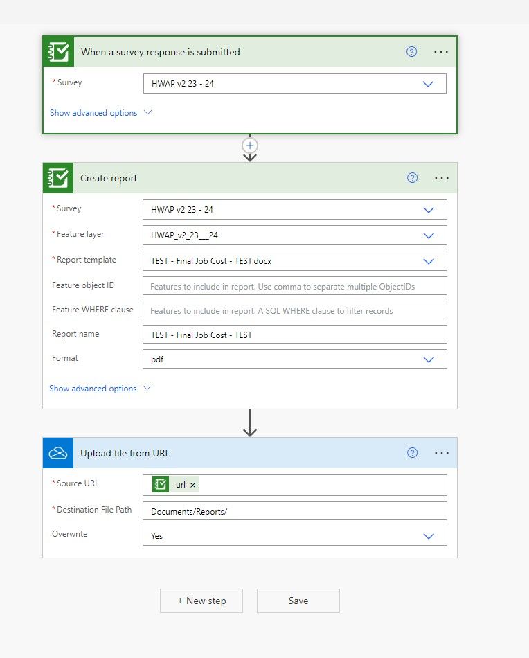

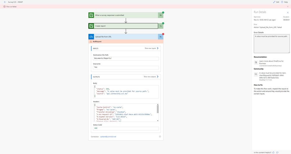

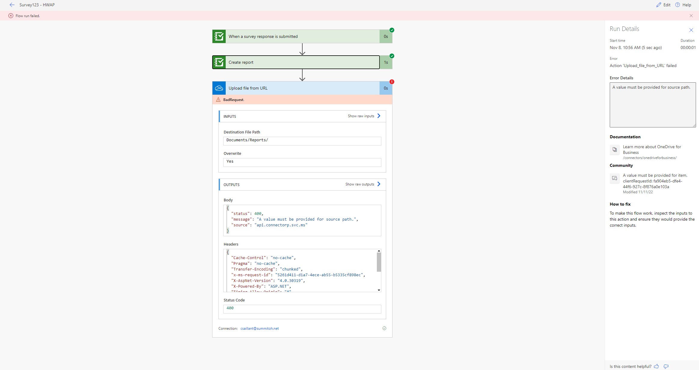

Hello everyone! I am new to Power Automate and I have tried everything! I have watched videos, gone through blogs, and everything else.. Still no results to making this work.. Please! What am I doing wrong?!
All I want to do is very simple. I just want when someone sends a report to have it sent to our OneDrive labeled Reports.  Screenshot 2023-11-08 105758.jpg

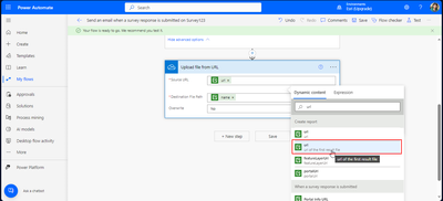

I've been replicating this flow for the past days and managed to find the proper configuration! When you are configuring the Upload file from URL step, make sure to select the Report URL pointing to the file (you'll see a hint text right below).

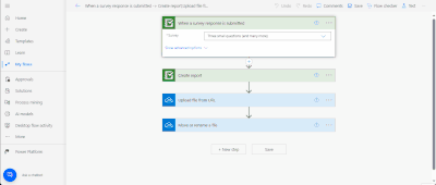

I would also recommend using the name of the report as the value for Destination File Path since this is the name OneDrive will use to save the file and it will include its extension (.docx or .pdf). Afterwards, you can use a Move or rename a file step to transfer the uploaded file to the desired folder
Here is a quick demonstration of my flow.
