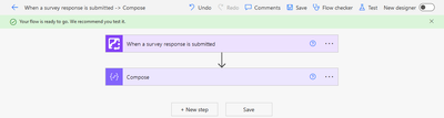

I just created two new flows.
1. Custom S123 trigger: Success
2. ArcGIS trigger: Success
Just make sure when you make a new flow that you get the form update in S123 or the flow won't trigger.

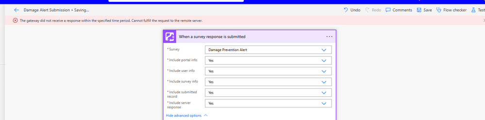

SaadShahzad
Also running into a similar issue in ArcGIS Enterprise. The old flows work just fine, but using a new flow and we get this error.Screenshot 2024-12-09 114237.png
