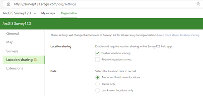

A worthwhile question to start - are you able to use location sharing in other apps? (eg: Field Maps or QuickCapture) This would help confirm if you have the tracking layer set up in your org as needed.
The Deploy a Location Sharing Solution with Survey123 document spends a lot of time on setting up the tracking layer in your org, and I have found that the last (critical) step can be easily missed. An org administrator does also need to enable (or require) location sharing in the Survey123 website:
Once this is done, when you sign into the Survey123 field app, you should see the 'squiggly line' icon.

Hi, this is the first app that we are using location sharing with.  My admin stated that he enabled sharing for Survey123 but now that I looked at his screenshot I see the problem. He enabled for Portal and we are testing on AGOL. Thank you for causing me to take another look at this!

Thank you. I was trying to enable this on the surveys themselves. In the main page of Survey123 web site next to My surveys. That is easily missed in the documents
