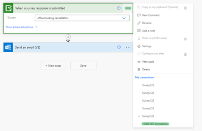

Here is a picture of what I am experiencing
As you can see the survey fields are not populating in the dynamic content. How do I rectify this disconnect between the Survey123 and MS power Automate?

Hi everyone, I am having a similar problem. In my case, my flow was working with no errors. And then suddenly 2 days ago I got an error. If I go to Survey123, the survey sent is stored in the table. And if I test by sending an old survey the email is sent ok. It's the new surveys that are having issues.
I am trying to create a new flow to solve this issue but I am not able to even see my surveys, it's like my account is not connected between Survey123 and Automate. Any help is welcome.

Try following my guidance above for reconnecting Survey123 to Power Automate. Hopefully this helps resolve finding your content.
For the flow not working, check to see if it was turned off due to inactivity. I’ve received notifications for this in the past when the triggers haven’t been activated in a long period of time.
MelissaK
I think you can also re-log in to Survey123 inside the flow
