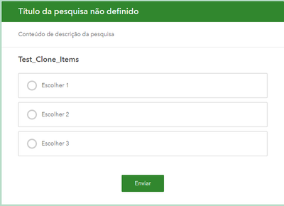

I'm sorry it took me so long to replay. All three forms a very simple and have Survey123 native questions.
The image below is for the first one, created using Survey123 website. And the XLSForm for the second one is attached
