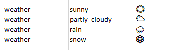

The first error message is typically returned when there are special characters in the survey. For example in the manhole community sample one of the choice lists has these special characters as the choice labels:
These characters will cause the error message and has been logged as BUG-000146678.
