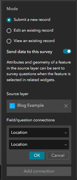

JenniferAcunto
You just need to use the Survey123 widget in Experience Builder. Once you toggle on 'Send data to this survey' you get additional configuration options to pick the source layer and map the fields to survey questions.
