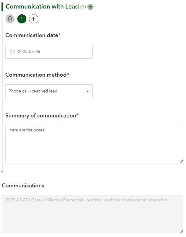

Hello,
I am trying to accomplish separating my concatenated repeats on a new line in the Survey123 Web App.  I am able to accomplish this in Survey123 Connect using "\n" however not able to replicate it in Web App. I have tried "\n" and <br> both with no success.

CoreyWilliamsESRIAccount
Hi Josh,
Thanks for this recommendation.  I am not an expert with javascript by any means and was hoping you could help me tweak this code to produce the expected results.  Currently I'm seeing the fields referenced as undefined and the line break not working.
Could it be this functionality is not available in the web app?

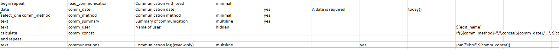

Here is the code:
// In your form field "bds_comm_concat",
// use pulldata("@javascript","notes.js","getCommSummary",${bds_lead_communication})
function getCommSummary(rows) {
	var commSummary = "";
	for (var i = 0; i < rows.length; i++) {
	  commSummary +=
		rows[i].bds_comm_date_text +
		rows[i].bds_comm_user +
		rows[i].bds_comm_method +
		":<br>" +
		rows[i].bds_comm_summary +
		"<br>";
	return commSummary;
