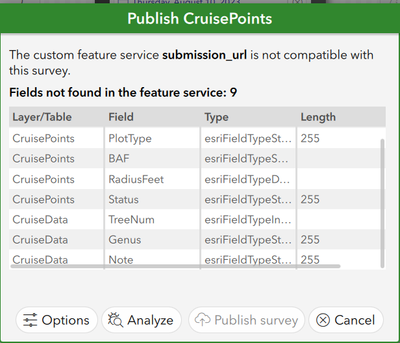

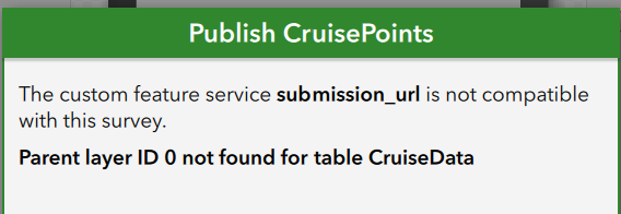

So my latest error is this:

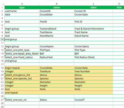

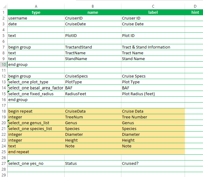

 Here is a screenshot of my survey excel sheet:
Any helps is much appreciated!

What do you have set for the form_id in the settings worksheet of the XLSForm? The form_id will need to be set to the CruisePoints layer.
Also what is set for the submission_url in the settings worksheet?

So I then switched the form_id to CruisePlots and tried to republish and got this error:

If you would like to use CruiseData and the layer the survey submits to you would need to remove all the questions before the begin repeat question as well as the repeat itself.
That message is indicating that you have questions in your survey that either do not have corresponding fields in the respective layer or the value in the name column of your XLSForm does not match the name of the field in the feature service.
Please see the Use Survey123 with existing feature layers documentation for more information.
