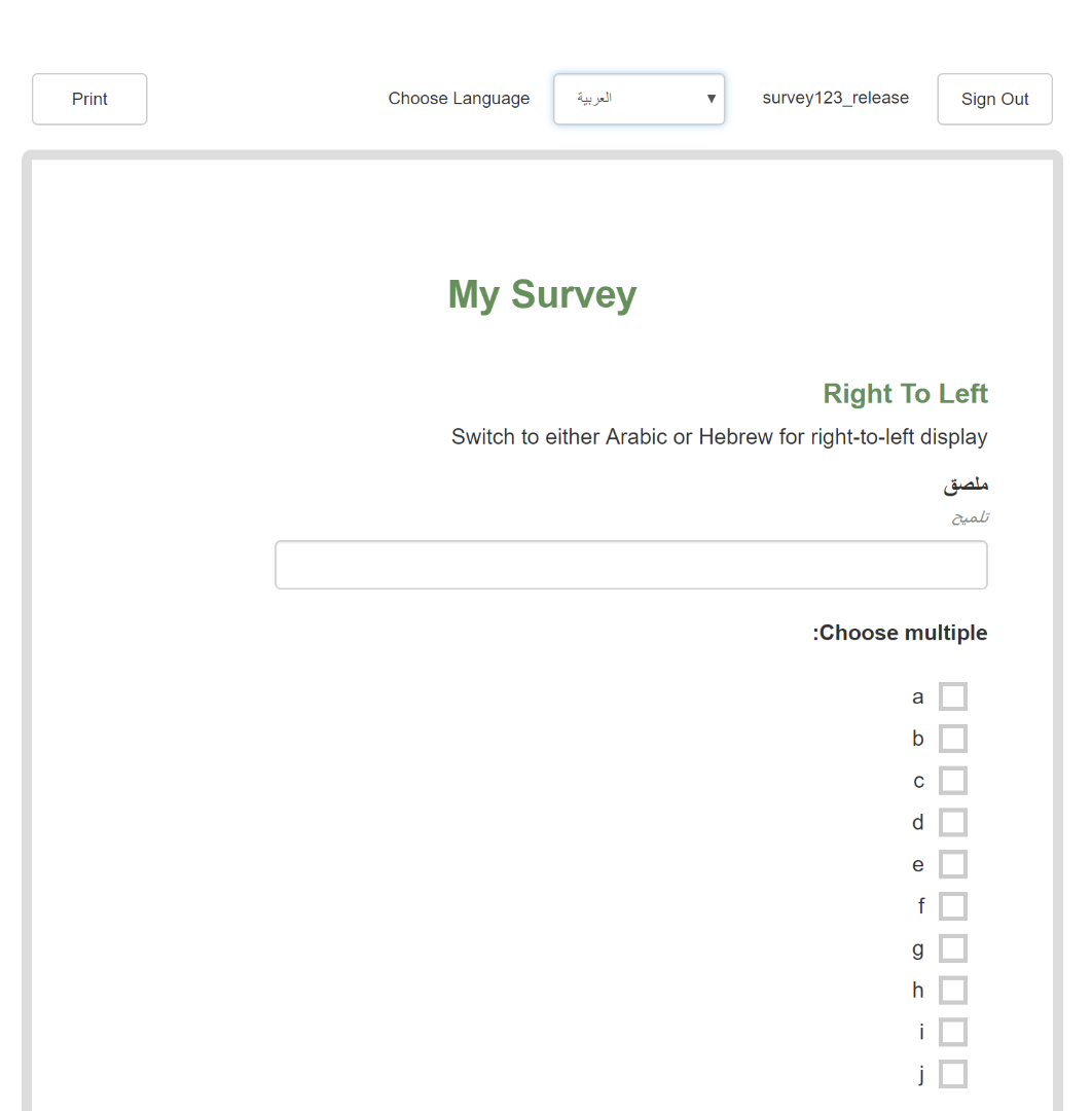

Because I turn to Hebrew language speakers I need to RIGHT ALIGN all the form (text and other input types, like radio buttons, one-selection and so on). I tried to use a .css file, HTML file but unsuccessful....
I there anyone who dealt with this kind of problem?
Is there any solution?

Survey123 supports right-to-left languages. However you need to author the survey in survey123 connect:
Multiple language support—Survey123 for ArcGIS | ArcGIS
Then you can view the survey in the webform:
Thanks
John
