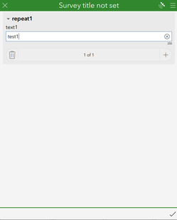

Repeat add/delete options when collecting new survey vs. viewing in inbox with allowAdds set to false:
