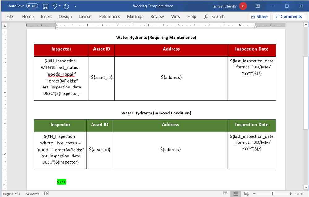

Hi Lance. I think you may want to use syntax along these lines:
In your case, the expression could look more like:
${#survey | where: "watch_report_item = 'Significant_Case' " | orderByFields:"time_of_incident DESC"}${case_}, ${time_of_incident}, ${incident_type}, ${location_checked} ${narrative}${/}
Also attaching a modified template here for your reference.
It is important that you keep the quotes straight. For example: simple quote: ' and double quote ".  Microsoft Word has a tendency to create 'smart quotes' and they generate errors in the Survey123 report engine. Check this: https://support.microsoft.com/en-us/office/smart-quotes-in-word-702fc92e-b723-4e3d-b2cc-71dedaf2f343

IsmaelChivite
Esri Notable Contributor

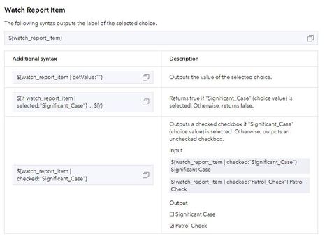

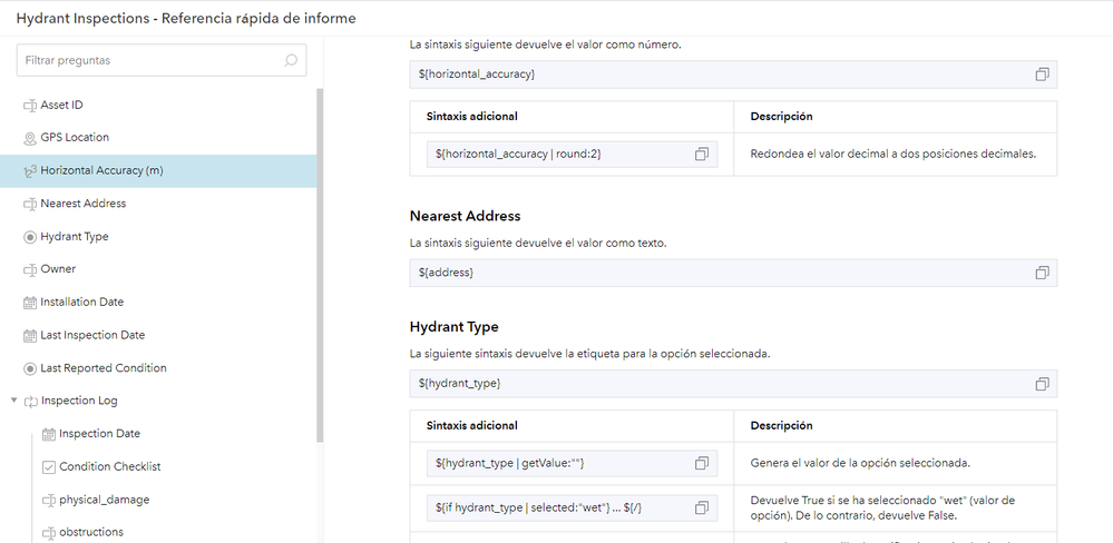

Hi. By the online reference I meant that cheat sheet page that appears in the Survey123 website where you can see the name of the different questions in your form. Like shown below. This page is important as it helps you get the right field names and values for your queries.
In any event, start with just on table and when you get the syntax right you can add the second. For example, drop Patrol Checks for now and lets focus on Significant Cases.
Attaching v15, although I am going a bit blind without the reference.
LanceEber
Gotcha, so this section?  All of my syntax looks right to me.
